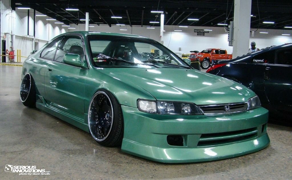

So I just read thru you're "lengthy" ( heheehee) build log over on H-S and I personally thought your 17x9 +20 setup looked GREAT man! And iirc you were even planning to go 17x9 +20 squared so I'm surprised you said earlier that you were rubbing bro? Can I just ask how much you had the car lowered at that time? Were you just on springs then or was that after you got your GC coilovers? I only ask this because I really don't feel like 17x9's with a +20-25 offset is very aggressive at all on the CD chassis.... It's almost the "standard" size for anybody going for a lowered and slightly "stanced" look on our chassis, is it not? I mean look at guys like iakona and it is i B*tches, or Zak325 that are running 18x10-11's, granted they run higher offsets and camber but my point is THAT is aggressive. I think 17x9 @+20 with the right size tires shouldn't be much of an issue?...albeit of course, that being dependent on the amount of drop and spring rate, etc...
Here's a pic of hahaha38's car (hope you don't mind bro?) and it's sitting on 18x8.5's @+35. Now I know this isn't the best angle to see it but there's definitely some room to play still in the rear. It's also dropped a good bit on D2 coilovers. This pic is just for reference for the OP and everyone questioning what will/will not fit.

Here's another one for reference... which admittedly is complete and utter insanity on this chassis btw.
But here's 18x10 +10 front 18x11 +0 rear:

x8.5 +35 isn't crazy at all. It fits the same as a x9 +41, or a x8 +29. With natural camber, you will have a little room to play with.
On my car, I don't have a front camber kit, so the front just sits where it is. For the rear though, with my functional setups, I've always adjusted the negative camber between -1.5 to -2, to help fill in the wheel wheels a bit more (especially on my Volks since, I'm reverse staggered.
What it comes down to though, is what you want. If you want as wide tires as you can fit for more grip, you have to sacrifice some offset. Where as if you don't care about handling as much, then you have more freedom to play with smaller tire sizes, and opens up the wheel specs you can fit on the car.
I'm a grip guy pure and simple. Once you do some hard driving with good tires, its hard to go back. Plus having the car at a functional height, and not worrying about small dips, potholes, bumps, or rubbing is a great feeling.
