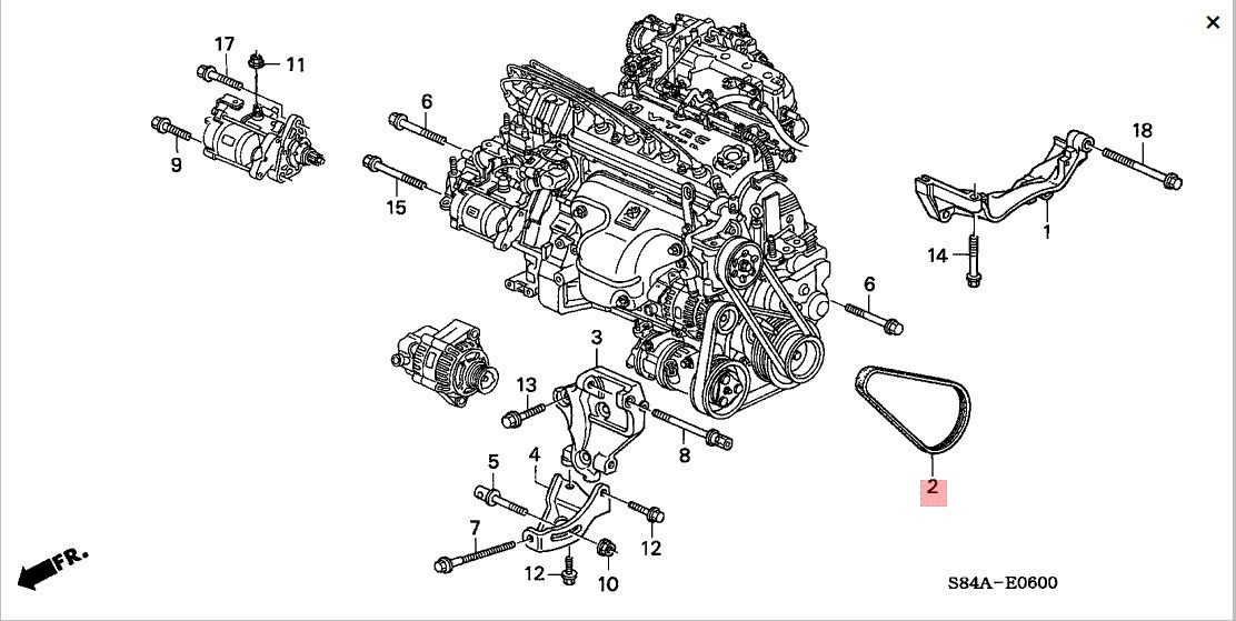

The Accord DX does not come with A/C. You can try the DX alternator belt, Honda part number 31110-P0B-A12, or an aftermarket belt.
It is #2 in this image and would replace the longer belt that goes over the A/C compressor pulley (triangular belt in the image).
