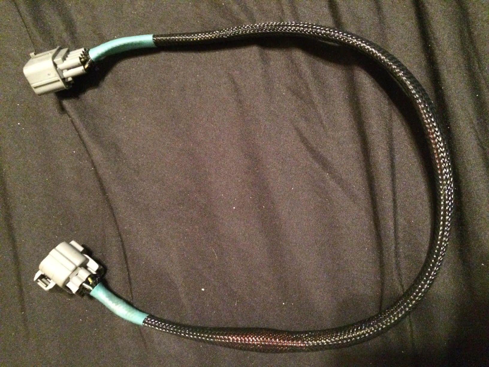

I went ahead and created the Extension adapter i needed for the wiring harness. Had a lot of telcon meetings this morning so i had nothing better to do. This is purely to fix the mistake i made when rebuilding the harness. Still not sure how the wires ended up too short but i didn't want to carve up the completed harness. I am definitely liking the wrap on the wires. In the future i think ill always use it to keep things clean.
8 pin Male to 8 pin female Extension cable.

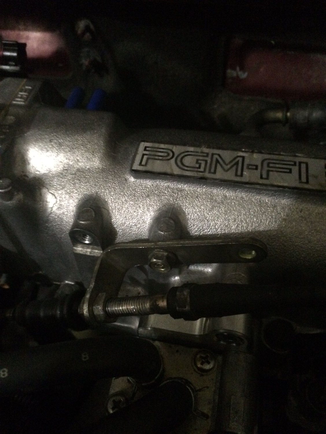

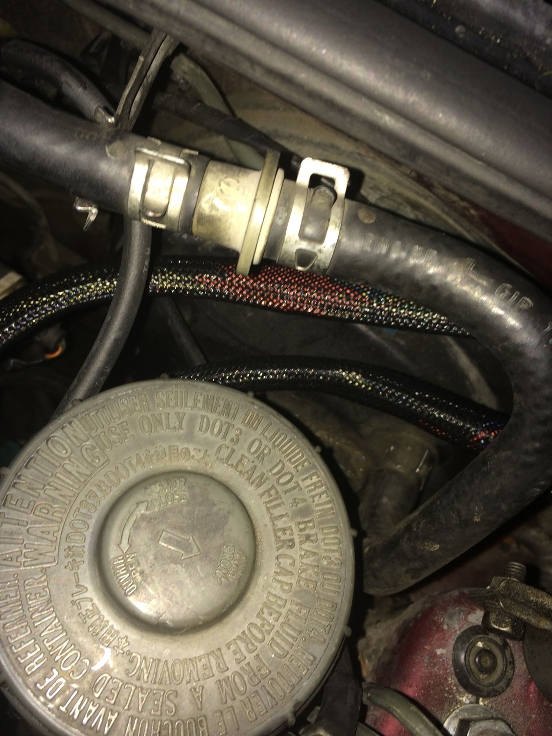

Ok spent a good amount of time today getting the loose ends completed. Crank pulley is on and Alt/PS belts. Plugged in my fancy new harness adapter. Got my intake installed, i was going to put on my old pod filter but its extremely old and never been cleaned replaced, ill order a new one. Installed my Skunk 2 Upper control arms.. crap just remembered i forgot to tighten a few bolts. . Started installing my grounding kit, it doesnt quite line up like it did on the F22b2 but i will figure it out. My assortment of cotter pins came in so i replaced all of the ones on the front end. Axel's installed and the transmission clutch inspection plate. I took a few minutes to cut off the odd adapter on the downpipe and did some comparing. Should be an easy fix, maybe ill head to the muffler shop tomorrow.
Let me say this.... I HATE INSTALLING Torsion bars. Every time it ends up taking me hours just for 2 bolts. I would rather hit myself in the nuts with a mallet than take them out and back in again.
Also... Lava Soap is awesome. Back in the day i used dish soap and then that orange crap. I had been using the orange stuff until recently and i grabbed some lava soap, its like magic.
I had some negative Camber since i installed my skunk 2 Shocks. I have been running the coilovers for years and just replaced the shocks in January. I did the 5 Lug conversion a few years back and i was able to get it dialed in to -1+1 camber but since i changed the shocks i have not had any luck. I purchased the 88-91 Crx Skunk 2 upper control arms. I had planned to use my stock mounts with the Energy suspension bushings but the CRX uppers are not as wide, i tried to pound them in without any luck. With the ones that came with the uppers its a tight fit but they did work, hopefully i am able to get them dialed in.
Fuel System Install, i may build a bracket for the filter.

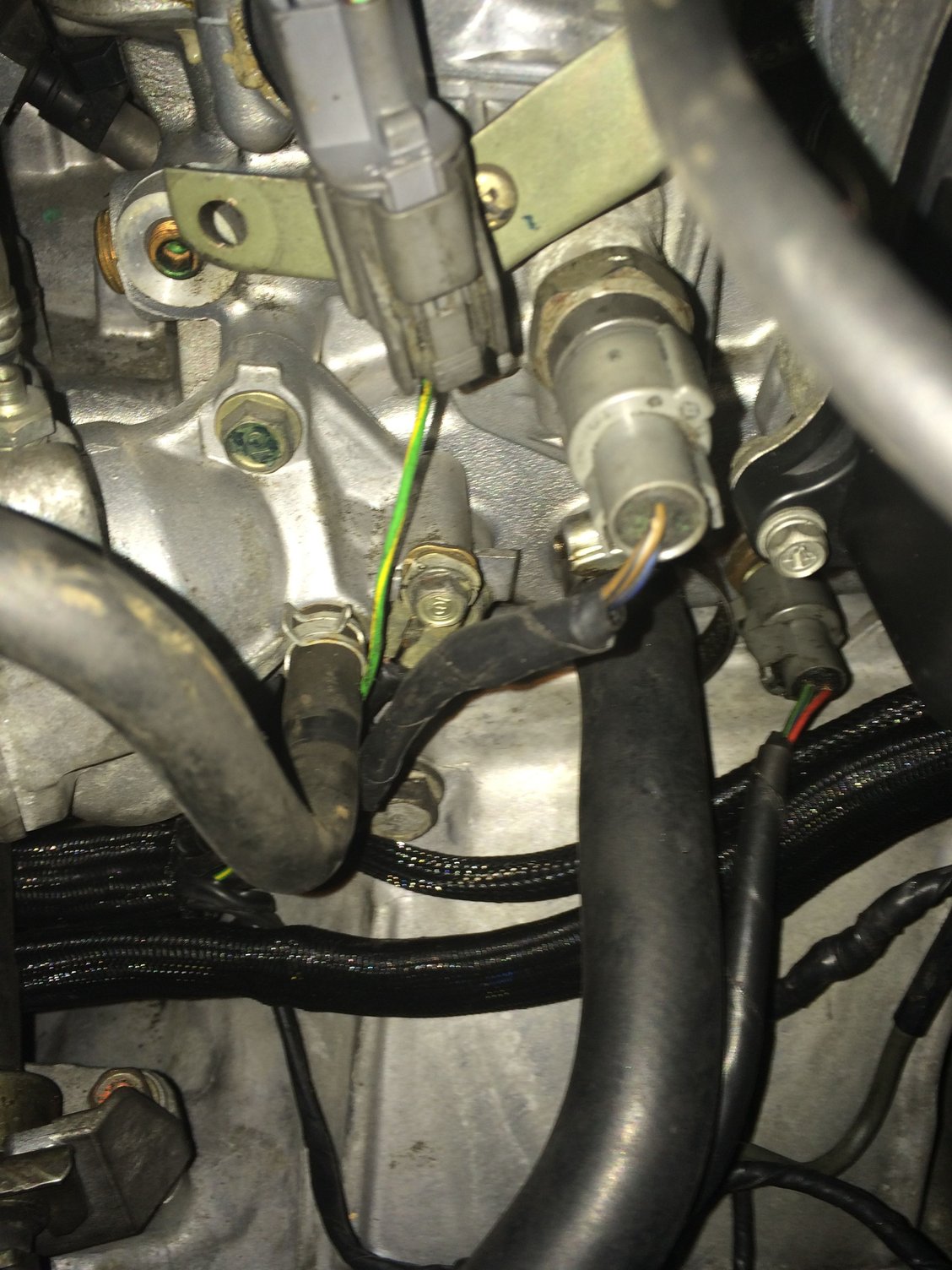

Driver side Harness wires
Transmission side wires, could use a little cleanup still but most likely ill leave them as is.
throttle cable mount. I was going to drill some new holes in the mount but couldn't find the drill under all of my mess.

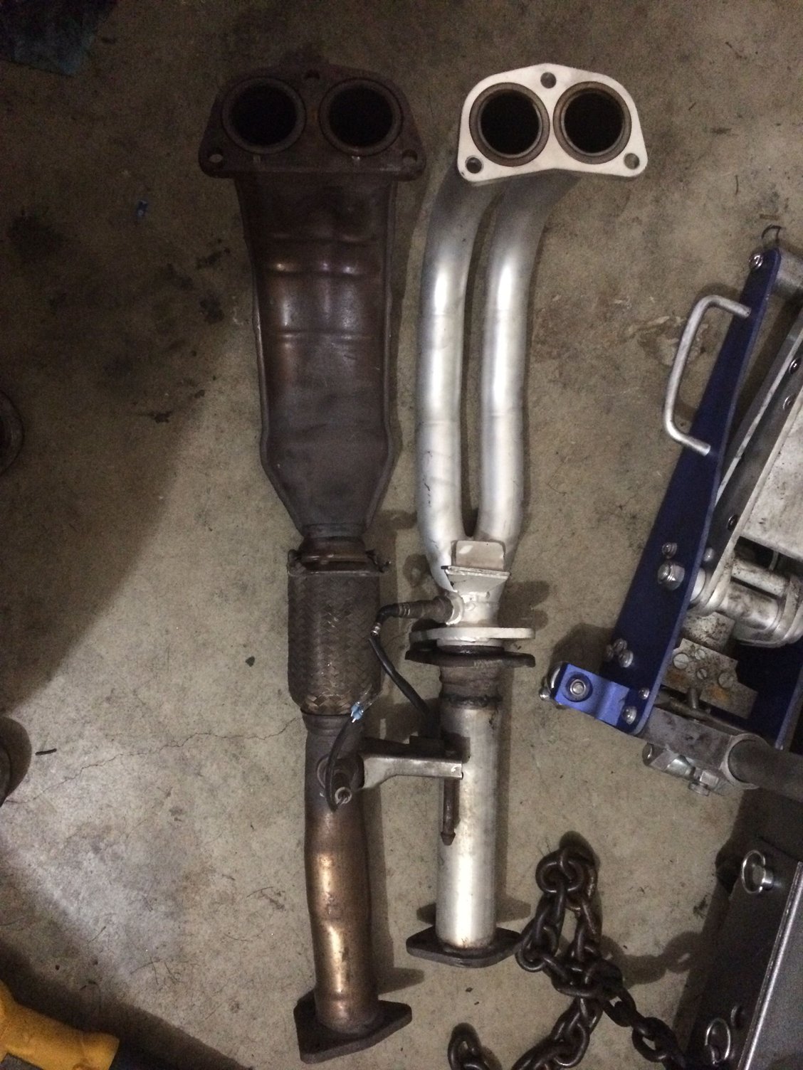

Side by side with the DC Downpipe from the F22b2 and the little adapter that was before my cat.The Length wont be a problem

I do not recommend using the JDM Downpipe, when swapping into a 94-97 Accord. The length is the first problem, then the flange then there is a mount that hits the rear crossmember, then.... the O2 sensor hits the crossmember. I saw a 4-2-1 ceramic coated header for pretty cheap on amazon, I think ill go with that in a few weeks and get things welded up properly once I have it.

I was looking online for a cheap header and I'm not finding anything that looks interesting. The Y design ones look cool but are expensive and I'm afraid that I will have issues with the fitment, the gap for the header and the front cross member is very slim. I cant install a 4-2-1 header without separating it first, I'm not sure a 4-1 or Y design will fit. I was looking for a ceramic coated 4-2-1 but they all have the stock O2 sensor position which is a problem with the rear cross member. I need to have the bung at an angle so I don't end up eating o2 sensors.
I'm concerned that I will have issues clearing the oil pan since there are posts saying that the H23 pan sits lower.
I'm at a loss at the moment, if I go and have the stock modified, I would want the bung relocated and I need everything welded up I'm sure the cost will be $60+. and it wont be an ideal header/downpipe.

I did some more digging and what it looks like is that most of the 4-2-1 headers have the o2 sensor bung before the flex pipe and on the JDM one its after the flex. I wonder why that is. Its hard to tell but that may "may" move it forward enough to clear the cross member. Anyone have any experience with it?
I also did some additional reading on the Tri Y designs and it looks like you need to modify the front cross member and the front motor mount, possibly remove the front motor mount. This is definitely not going to work for me.
Back to the 4-2-1, almost all of them have a 2inch collector, I did a quick measure on the JDM one and the inner pipe diameter looks to be 2 inch. I'm not sure there will be any performance gains at all with the aftermarket headers. I can see the 4-1 and the Tri Y gaining some HP but not with the 4-2-1.
I'm thinking ill order a 4-2-1 mainly for the o2 relocation and because they look nicer, can anyone confirm the location fits for a 94-97 Accord. They all pretty much look to be identical. I'm thinking ill get a kit with the test pipe so I can steal the flange

The cheap headers are not going to get you much of anythig in terms of power. Custom, or the plm copies are your best bet as far as headers go.

I see the word custom thrown around a lot, I'm just not seeing it as being a valid solution. I honesty think a production dyno proven header would be the way to go if I was looking for power. It seems like the tri y design would be the favorite with the ram horn somewhere up there as well. There are a few other 4-1 setups out there with a decent size collector, I guess you would go custom when you want to focus on making power in a certain power band but most likely you would end up with performance similar to one of the production pieces.
My concern at this time is fitment then looks secondary and not soo much performance. I don't want to lose any performance. Most of the 4-2-1 headers seem to be pretty much on par with the stocker. the pipe size may be a little bigger from the individual ports but the collector is still only 2 inches. I think the bottle neck is the cat usually.
I did see some decent deals out there but I have serious concerns about fitment. The 4-2-1 headers are the ones I feel are least likely to give me issues. I was hung up on the ceramic coating but after a bunch of reading it makes very little difference in sound, it mainly affects heat.

Custom headers aren't realistic for alot of people, they're not for me. I'm not spending $1000 on a header, it's just not happening. The PLM headers on eBay have a good reputation here as far as power production and fitment go. They might need some customizing as far as the flange goes, but they're meant for the Prelude/Accord, and the collectors are 2.5". The Ram-horn header looks amazing and I would love to have it, if I honestly thought it would gain me anything. There is very little information out about it and what there is indicates it interferes with the AC line. From what I understand about header design it would probably work better with a H22 or F20B than a H23. My issue with is is that half of it would need to be replaced in my case as it's a 2.5" pipe and I would want 3". Anything that would get an exotic piece of steel like that would need the flow.
