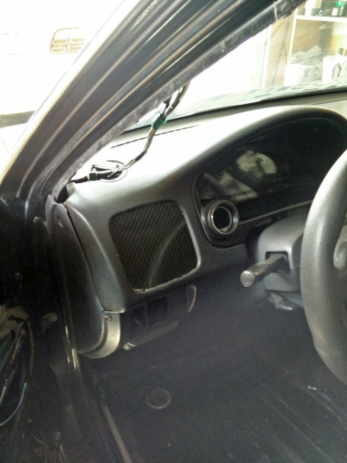

Carbon Fiber block offs
S2K cluster and gauges all wired in and work perfectly
Full Interior shot including airbag delete
PCI seat mount & Kirkey seat full bolted on and stable
Final shot of the GE diffuser.
