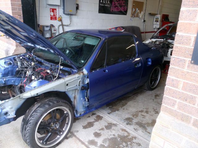

Engine's out ready for tear down and shell sent to the body shop. Will update over the next 4-6 weeks with engine work and when the body shop is done with shell.

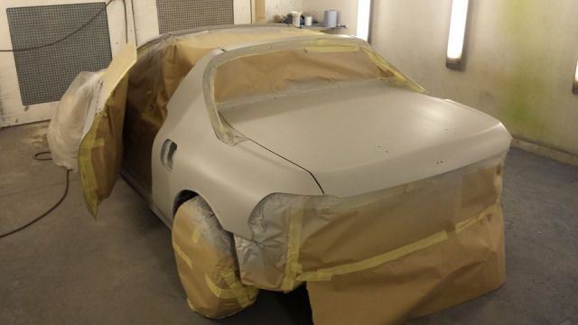

Slow progress but still non the less it's some progress. Body work is now done and time to work on the engine, suspension and brakes.

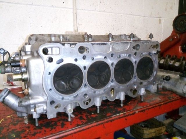

Going no where with my old builder and months of delay I've ditched him and gone else where and since then we made hell of a progress.
I had to send block and head to for machining else where after sat nearly 7 months at the old builder giving excuses after excuses.
Things have gone so quick that now at this rate I'm hoping to have the engine in the car by next week.

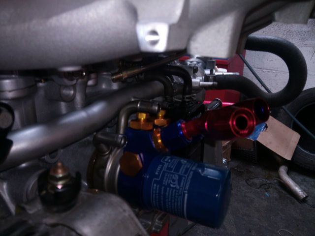

Only thing I seem to be struggling with now is installing the oil sandwich plate as these JDM B16 didn't come with oil cooler and the oil sandwich plate won't sit flat on the block without touching someone thing on the block it self and finding a 0.060 or 0.065 oil restrictor since most out there seem to be for BB turbos and 0.035" or 0.040".

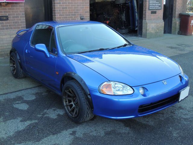

We'll finally got her started yesterday and it fired up straight away after priming. Took us about good hour or so to figure out the leak from the throttle body as the thermal gasket wasn't the right size, but the guys down the garage literately think out of the box and made a paper gasket out of a card board until I get OEM or right size thermal gasket. The 10:4 pistons and 0.030 head gasket result was a very high compression, 270psi on all 4 cylinders. Will update more once its tune, exhaust is complete as at the moment just running 3" down pipe and across to the back but no back box yet.
