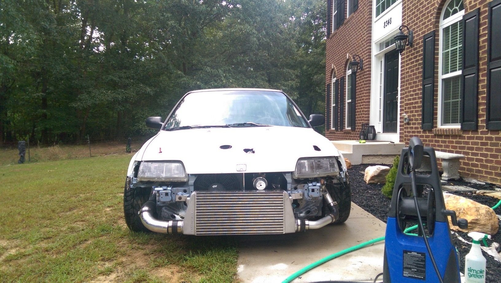

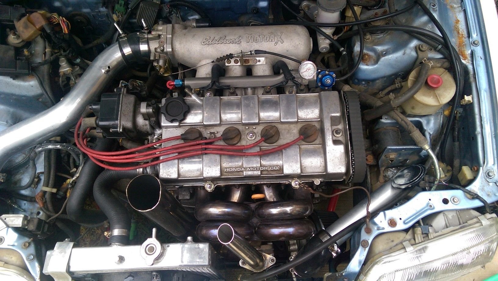

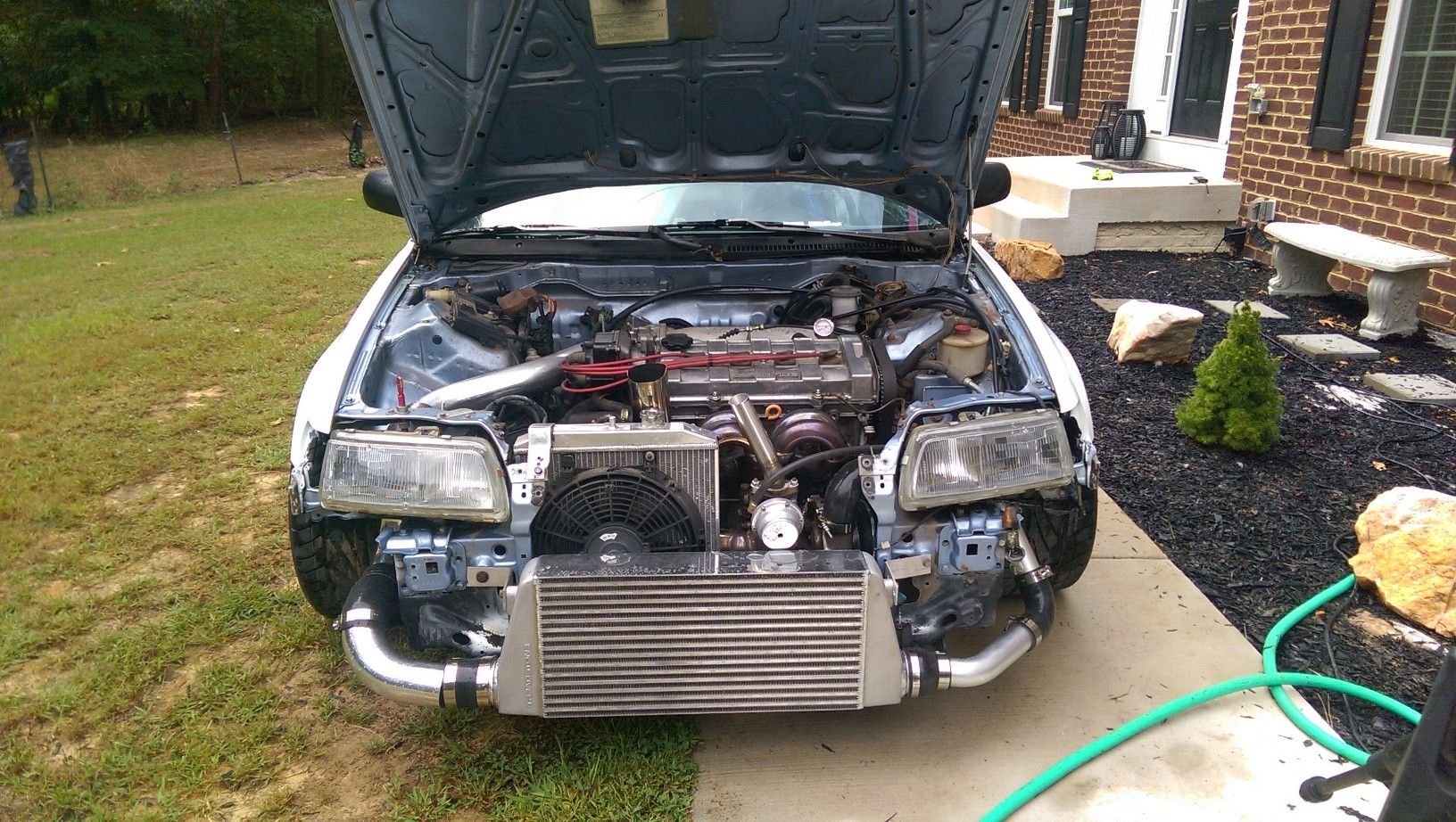

Well I finally got this thing together after a few years time between work... wife baby etc.
Right at the end of tuning I ran into an issue and it's stumping me...
Setup:
89 dx hatch
Auto to manual conversion
Dpfi to mpfi conversion
Monotech obd0 to obd1 conversion harness
81mm sleeved ls block O-ringed
Forged pistons rods
PnP PR4 head.
Crower 404s titanium valve springs and retainers
Custom ram horn
Precision sc6152e turbo
RC 1000cc peak and hold injectors
GM MSD 3 bar map sensor
Edelbrock intake mani
aem fuel rail and apr
Tuned on crome
Only issue I had prior to our first tuning session was a TPS CEL (#7) which was intermittent and went away with proper calibration.
16deg base timing confirmed
Anyways I got everything running we went out tuned partial throttle then started doing pulls on 7psi (on spring, waiting for boost controller) just to get everything going get a baseline. This is on Crome btw.
So we pretty much got everything tuned on 7psi felt good in that small Hatch for sure!
Coming back home partial throttle started popping and misfiring a bit here and there and we changed nothing on the live tuning at all for it to start acting up. Get into boost it breaks up a little bit and then off throttle I'm throwing big flames popping(hood exit exhaust). Park it for the night.
Next day I drive over to my friends to get a bigger waste gate spring and it starts breaking up even worse and at very light partial throttle too. Pull plugs. Black fouled. Replaced with new (7s, gapped .025). Clears up some for about 5-10 minutes of driving but still light popping/misfire. I'm thinking probably coil? But more symptomatic of an ignitor. I then change the entire dizzy (stock) with the friends known to be working msd cap/rotor dizzy with msd wires and installed a blaster ss external coil.
It runs the exact same. No different at all.
Mind you we changed NOTHING in the tune and it was same weather everything.
Burned a chip to 2 different computers to try plus the tuning computer. No changes.
New plugs nothing.
Mind you it always ends up with rich fouled plugs everytime I changed them.
Base timing is correct. The tune is good (we tune alot of cars) but we don't/haven't used crome in forever. I want to get hondata or neptune maybe eventually but I've never had a crome issue that I knew of in the past.
I'm guessing it's a ground issue
Engine ground? Trans? Battery has good ground...
(ecu grounded 2 feet away to chassis via conversion harness)
Wiring issue came loose somehow???
Bad Injector resistor box maybe?(have rc1000 peak and hold)
Injector sticking open?(Idles perfect though!)
Idles perfect. It's only under load.
Running a MSD GM 3 bar MAP sensor (could be bad?)
2 different dizzy setups and same issue is what threw me off. I could of sworn this was going to be a coil/ignitor/plug wire issue...
I'm lost with what to do next. I guess I need to start tracing every wire in the harness etc and see if something came loose because this isn't making much sense to me.
I'm thinking of buying a cardone replacement stock dizzy and trying that as well. If that doesn't do it I'm not sure what to do after that...
Any ideas?

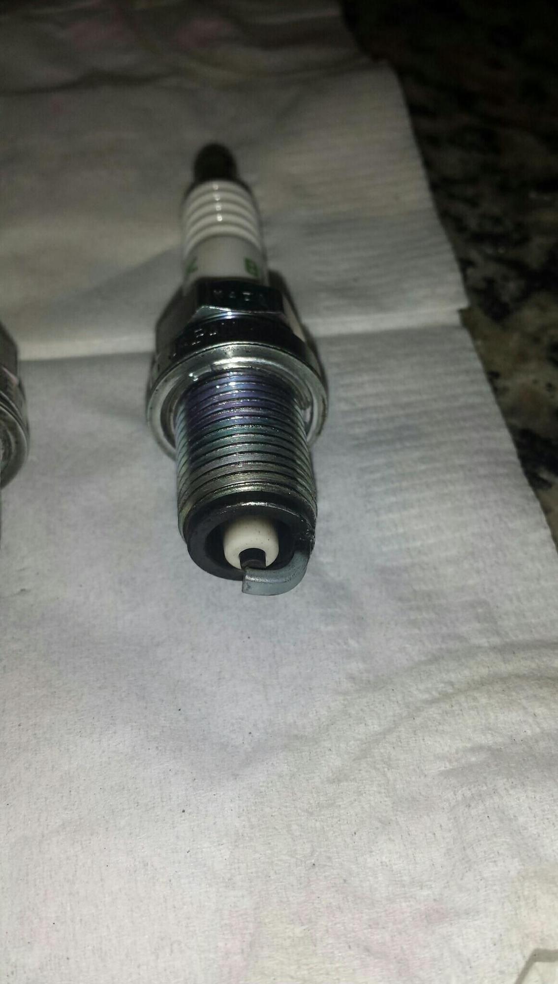

Posting plug pictures momentarily...

Posting the plugs just show if it's sparking evenly and some EGT indicators. I wonder why people here don't use EGT gauges anymore. hmm..

Here are a brand new set of plugs with a partial throttle 5 minute drive after and idle warm up....
#2 isn't firing the threads are clean but maybe was firing at some point(porcelein).
#4 is awfully clean but firing.

It's not whether or not it's firing at all, but how it's firing.
Try another distributor with possibly a better ignitor.
OR.
More to the point, keep the distributor and add the Accel Ignitor into the current Distributor. It actually bolts right in, and does a fantastic job. Picked up one for my spare OEM distributor.

Damn plugs look terrible. Oil fouled too? I'd check compression on that engine. Is there oil sitting on top of the pistons? Or injectors sticking open?
Yeah I run that accel coil posted above and have good luck with them.
I have a pyrometer I just haven't installed it yet cause I was just doing some mild pump gas build on conservative boost <15 psi and I'm pulling .9 degrees per psi still as well. When I get the hondata, boost by gear, EGT in I was planning on turning it up some on a different fuel.
OR.
This is the second distributor I've tried. I am thinking of buying a brand new dizzy (cardone) and swapping that ignitor in and see what happens.
I'm going to do a compression test tomorrow.
Base line before tuning was 180 188 190 193.
I haven't adjusted the valves after the heat cycles yet either should add that to the to-do list.
The misfire ended up coming in kind of gradually and intermittent and finally it ended up at this point.
I've got to get my friend over with his laptop with the crome pro on it also so we can try and datalog and trouble shoot that way as well. Still though we tuned for a couple hours and had everything perfect before this issue popped up. It's not smoking either other than start up just a tad.
