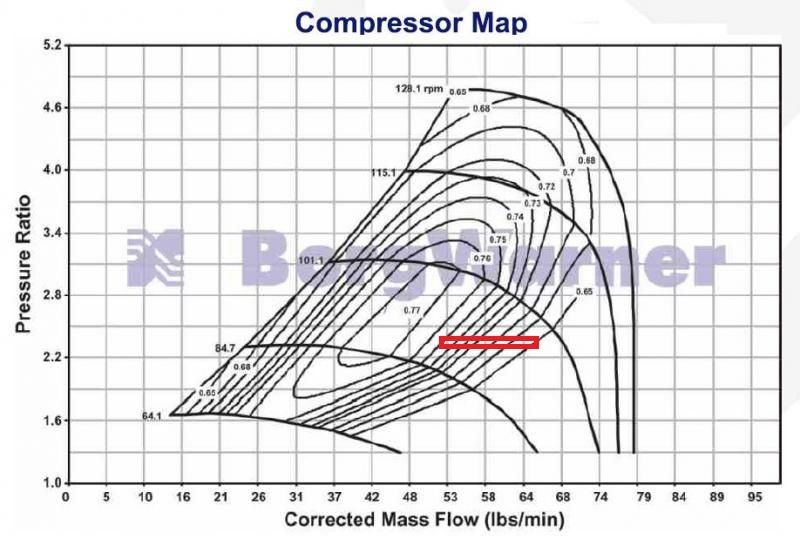

Did you monitor the turbo shaft speed sensor? Curious where 19psi on a 2.0 K-series lands on the compressor map.

Dont need shaft speed to determine that. Quick calculation gets me right around 63 lb/min at that power level (based on whp number * 1.15 for crank hp)
19 psi is ~2.3 PR
