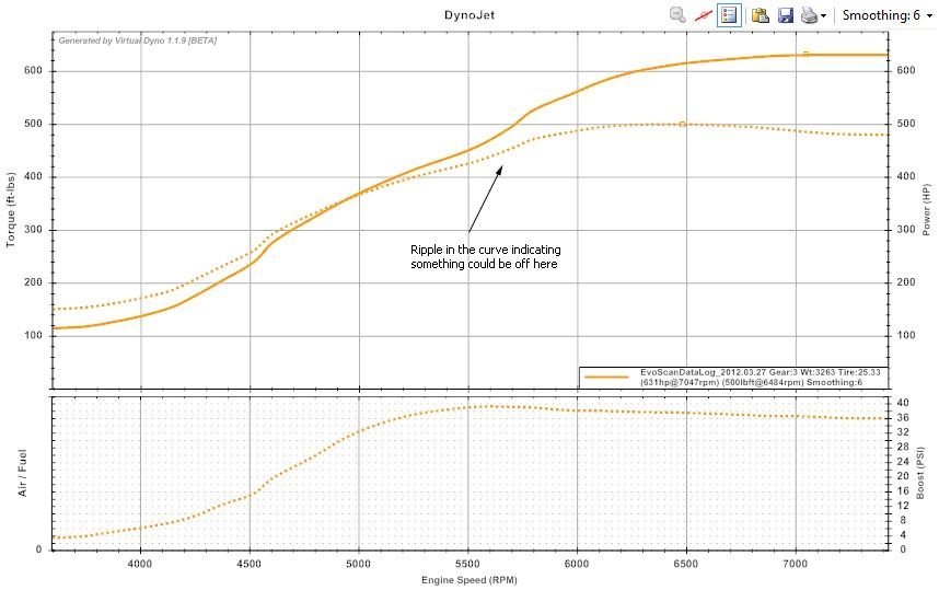

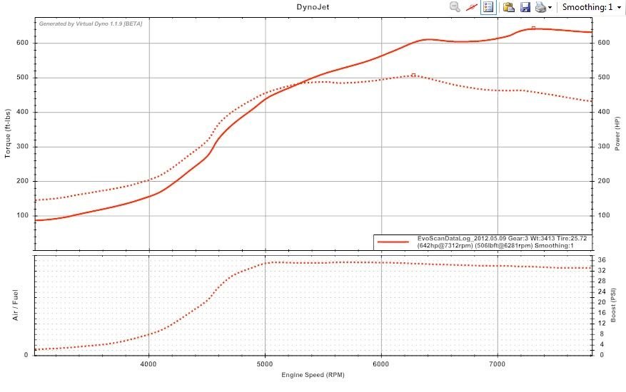

Misuse of the smoothing feature can mask incorrect or inflated runs. The first graph is smoothed correctly and is acceptable and should be considered accurate, while the second graph is under smoothed and is considered “inflated”.
While the second graph may look “Okay” to the average viewer, it is under smoothed, which is making a bump of power at 6500rpm, that will lead to inflated numbers. This run needs to be smoothed more, but for now, lets have a closer look at this graph with smoothing 1:
As you can see, with smoothing 1, its very apparent that the bump is unnatural and inflating the numbers. And although we can smooth this graph to the point it almost looks accurate, as seen below, the real solution would be to discard this log and get a better log. If you have to use max smoothing to make the chart look right, most likely the log is incorrect and shoudnt be used. This is over smoothing and shouldn’t be done.
