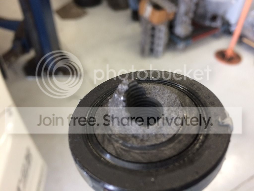

So on Tuesday, I started prepping the car for webcam pro's, pulled the head off the car and got while I was cleaning everything up Joe and I went to pull the cam gears off my skunk2 pro 1's and got the first one off and Joe was tapping the other cam gear off when this happened.
So the last event after I made a pass I was cooling the motor down when I noticed the intake cam gear bolt was gone. I was happy because at some point in the pass the cam bolt backed out or something and I was happy the cam gear didn't come off. So before this event doubled checked the cam gear bolts and even had Joe put locktight on the bolts. During the event no problems but taking the cam gear off this happened, I'm think the reason the bolt may have backed out last event was because the cam cracked. Maybe not too bad but enough for the bolt to slip out, after this event with a little tapping on the cam gear it just broke the rest off. I was lucky LOL
Car looks great, I love black drag cars ! Had a Pro 1 cam break off similarly on our drag car whilst it was idling ! Luckily it happened on idle and didn't cause any damage before we shut it off due to a rough idle...
Yeah I was lucky as well, I'm glad the head is off and everything is being looked at. For my new cam setup I needed stiffer springs so those are being replaced and found out yesterday the retainers are pretty worn so those will be replaced. So I'm hoping I will be ready for IFO in February.

Default Re: 2013/ EK Drag Build
Well after pulling the head, basically the entire valve train was replaced. Valves, valve springs, retainers, locks, and seals along with the new cams were installed and I finished putting the remainder of the car back together yesterday.
