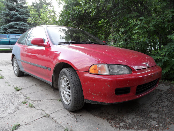

Back story: Vehicle was a salvage purchase in Nov 2011. Paid about $600CAD. Always wanted a 5G Hatchback with a sunroof. (The timing was good because I had just moved provinces and my vehicle at the time (a VX) would have required considerable work to certify it in the new jurisdiction.) The write-off damage on the Si was due to a dented front front fender and broken corner lamp. It also had a dented p/s door from a previous incident. Vehicle history is unknown, aside from the fact that the PO clearly went to McDonald's a lot based on the trash that was in the car when I picked it up.
Here are couple of photos from the original auction sale:
It was originally a USDM vehicle, and I *believe* it was imported to Canada in 2002, based on the inspection sticker on the car's door jamb.
I tinkered on a few things on the car but it basically sat until Spring 2012 when I had time to put towards getting it road-worthy again. It required some fairly minor maintenance bits to re-certify and get back on the road (front shocks, rear brakes, windshield, windshield wipers, etc.), but DID require some rust repair on the rear quarter panels which I had professionally done. No paint though because the whole car needs a coat. You know how it is.
Here's how it looked in Summer/Fall of 2012. Nothing too special but at least safetied and road worthy.
You can see it's riding high in the front - that's due to a couple of Integra shocks I put in there just as a stop-gap until such time as all four corners are redone. The rims are basically the OEM JDM 1995-only 5G Civic 14" Honda Access Optional "Modulo" "Mesh" Aluminium Rims, wrapped in Nokian 'WR G2' P185/65/R14 All-Weather Tires. (Rims are also available locally in Canada ... with a little research you can figure out where. )

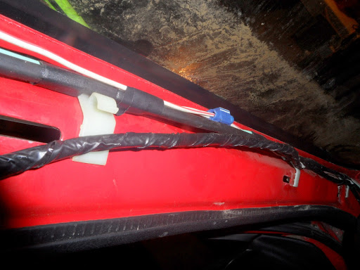

And since this is the third time I've done this retrofit, I've learned a couple of things. One is, tie a rope to the door connector to pull it up through its hole in the frame:
Two is, run the wiring harness along the glove box frame. This is how Honda does it on the 4G Civic Optional power windows install (a CDM Option) as well as how Honda runs the wiring on the OEM Honda Access JDM 5G Civic Heated Mirror wiring. So, it's really the ideal spot.

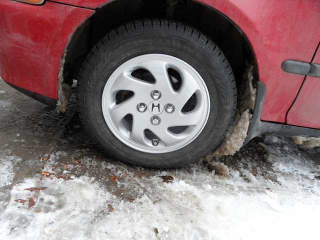

Fast forward a bit to winter, now. I don't run the All-Weathers in winter, so when it hit, it was time to switch these out. I imported some OEM JDM 5G Civic 14" Honda Access Optional Si/EX-style Aluminium Rims, and had them professionally refinished. These are wrapped in Nokian 'Hakkapeliitta R' P185/65/R14 Winter Tires. These are the top-of-line studless winter tire - I don't screw around with winter tires - I prefer to get the best.
Refinished and tires mounted:
From the JDM Catalogue:
And installed:
I put some McGard's on there for good measure. Let me tell you that they didn't stay that nice and clean for very long.
