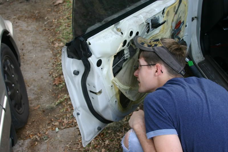

Step 3: Pry away some of the plastic covering. Stuff's used to keep moisture out and whatnot.
Step 4: Wonder how and the hell you're gonna disconnect that one rod and look puzzled:
This is what you're gonna see when you look in there:
Step 5: Using yoru 10 MM socket/extension, remove the bolt closest to the hinge and with your 10 mm wrench, remove the other 10 mm bolt. I could'nt find my 3/8 socket at the time, so I had to use a el cheapo thing ( can't think of it's name )

Step 6: Have fun removing the door handle! There are 2 rods. One for the lock and one that actually opens the door. The one that opens the door is connected with a little plastic piece that holds the rod in place. You have to twist and turn to get it to come out of the little holder. Not too bad. The other rod.. Well, thats another story.
Step 7: Remove plastic rod holder thing. I wish I knew the proper name. It's connected with 2 screws.
It's also connected to the door lock with a little clip. Just pry the clip off with a screwdriver. It comes off like so.
Step 8: Remove lock. Very simple. There is a little metal clip you pry up and pull out that holds the lock in place. If you want to use your original key, you HAVE to do this. Once the clip is removed, the lock pulls out.
Step 9: Hard part: removing the door lock rod. Look closely at this picture. Directly above where my first finger is on my left hand is where the rod goes. You can see the end of the bushing there and thats the hard part: You have to PRY on each side of that little bushing that holds the metal piece in while at the same time pushing/pulling the metal part out.
Sound confusing? It is. Hard as hell to do it too. I don't even remember how long it took but my fingers were killing me by the time I figured it out. I removed it from my new door handle first, then on the handle that was still connected to my car. Once you remove the one connected to yoru car, you can remove the handle completely and just stick the metal piece into the bushing and it clips in place.
